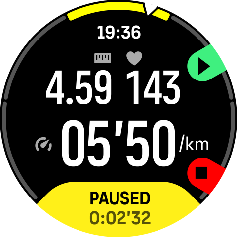

Press the upper button to pause the recording. A timer starts blinking at the bottom of the screen showing how long the recording has been paused.
