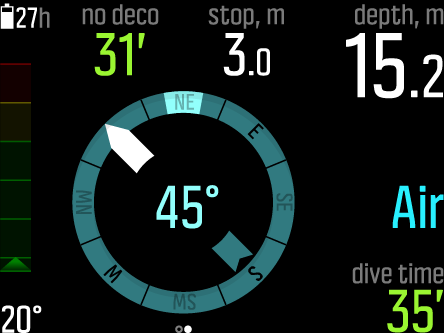

Suunto EON Steel includes a tilt-compensated digital compass, available as a main view.
view compass

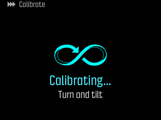

Calibrating compass
When you first start using Suunto EON Steel, and after each charging, the compass needs to be calibrated and it is required to do so to activate it. Suunto EON Steel displays the calibration icon when you enter the compass view.
During the calibration process, the compass adjusts itself to the surrounding magnetic field.
Because of changes in the surrounding magnetic field, it is recommended to re-calibrate the compass before each dive.
To manually start calibration:
  1. Take off your Suunto EON Steel.
  2. Keep the middle button pressed to enter the menu.
  3. Browse to General » Compass.
  4. Press the middle button to enter Compass.
  5. Scroll up or down to select Calibrate.
  6. Start calibrating the device by trying to move it around the xyz axes of the coordinate system (like you were drawing a small circle) so that the magnetic field is as stable as possible during the calibration. To achieve this, try to keep Suunto EON Steel in the same location and do not move it around using large movements.
  7. Repeat the rotation until the compass calibration is successful.
    Calibrating turn and tilt Eon
  8. A sound indicates when the calibration succeeded, and the screen goes back to Compass menu.

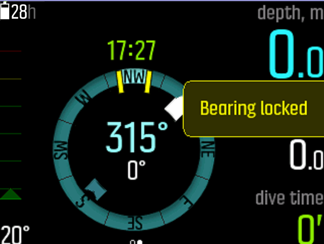

To set a bearing lock:
  1. Press the middle button to change to the compass view.
  2. Hold your Suunto EON Steel in level in front of you, with the top pointing in the direction to your target.
  3. Keep the lower button pressed until you see the Bearing locked notification.
Bearing locked Steel

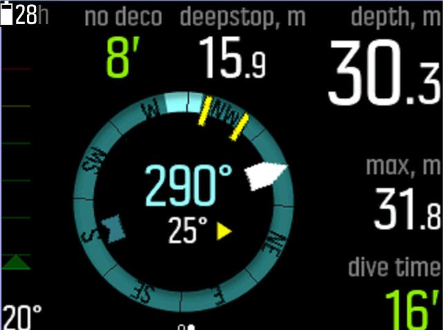

Once you have a bearing locked, the lock position is indicated on the compass rose, as shown below.
bearing locked diving steel
Below your heading (large number in center of compass), you also see the relative difference between your bearing and your heading. So, for instance, when you want to travel in the exact direction of your bearing, the lower number should be 0°.
