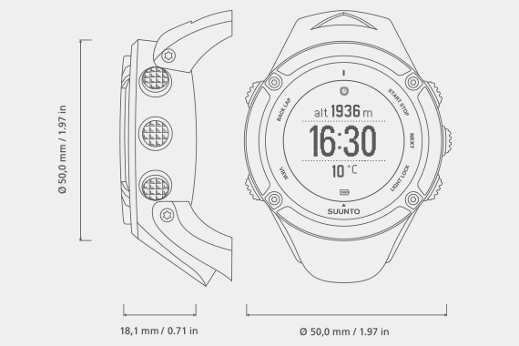

Maße | 50 x 50 x 18.1 mm / 1.97 x 1.97 x 0.71 " |
