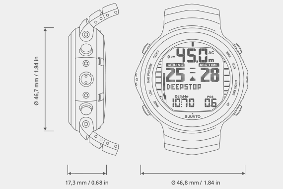

Measurements | 46.8 x 46.7 x 17.3 mm / 1.84 x 1.84 x 0.68 " |
Weight | 182 g / 6.42 oz |
