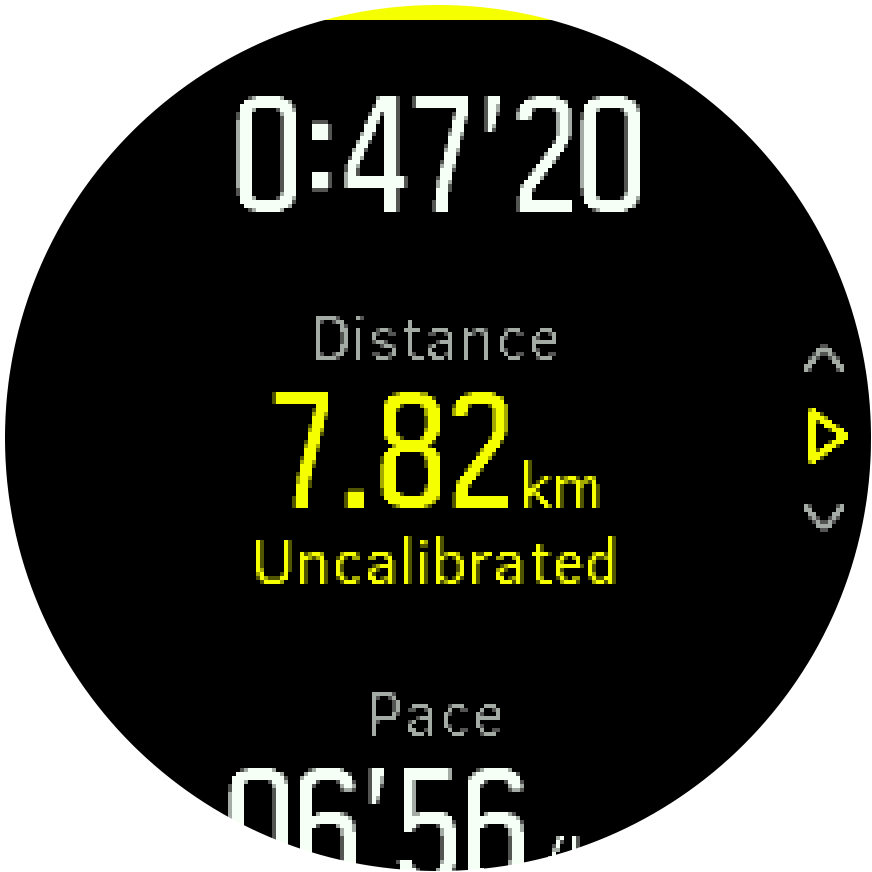

Speed and distance calibration
Suunto 3 Fitness is able to measure running and walking speed and distance using the built-in accelerometer of the watch. The accelerometer needs to be calibrated to your personal stride length and movement. Uncalibrated, the watch cannot correctly measure speed and distanced.
The easiest way to calibrate your watch is to record the first running or walking exercises with connected GPS (See Connected GPS). When using the GPS of your mobile phone, the speed and distance calibration is done automatically in the background.
To manually calibrate your watch:
  1. Record a walking and running exercise with a known distance (for example on a track) and for at least 12 minutes, see Recording an exercise
  2. Edit the distance after your exercise in the summary by pressing the middle button when the distance is highlighted.
    SF3 Distance Calibration
NOTE:
To get the most accurate result, manually calibrate your watch separately for both running and walking.

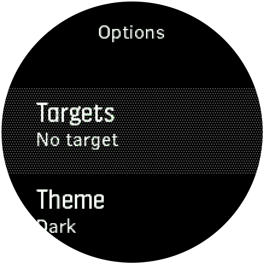

Using targets when exercising
It is possible to set different targets with your Suunto 3 Fitness when exercising.
If the sport mode you selected has targets as an option, you can adjust them before starting the recording by pressing the lower right button.
Sport Mode Targets Trainer
To exercise with general target:
  1. Before you start an exercise recording, press the lower right button to open the sport mode options.
  2. Select Targets and press the middle button.
  3. Toggle General on by pressing the middle button.
  4. Select Duration or Distance.
  5. Select your target.
  6. Press lower left button to go back to the sport mode options.
When you have general targets activated, a progress bar is visible on every data display.
ZoneDisplay Progress S3F
You will also receive a notification when you have reached 50% of your target and when your selected target is fulfilled.

Display theme
To increase the readability of your watch screen while exercising, you can change between light and dark themes.
With the light theme, the display background is light and the numbers dark.
With the dark theme, the contrast is reverse, with the background dark and the numbers light.
The theme is a global setting that you can change in your watch from any of your sport mode options.
To change display theme in sport mode options:
  1. From the watch face, press the upper right button to scroll to Exercise and press the middle button.
  2. Go to any sport mode and press the lower right button to open the sport mode options.
  3. Scroll down to Theme and press the middle button.
  4. Switch between Light and Dark by pressing the upper right and lower right buttons, and accept with the middle button.
  5. Scroll back up to exit the sport mode options and start (or exit) the sport mode.
